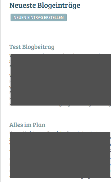

We use the Blog Posts Macro to display the Blog-Posts on a specific page.
If you view the page normally you dont see any information about the creator or the day it was posted:

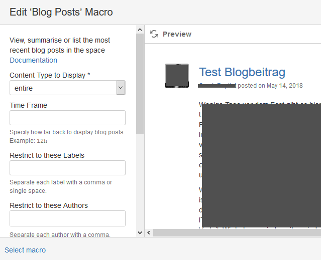

If you edit the macro you see all the wanted details. Also in the Preview everything is right:

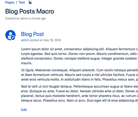

Hello Tobias,
Could you let me know what version of Confluence you're running, and if you have any customizations on the space or instance?
I just tested this on a fresh install of Confluence 6.9.0, and I can confirm that the author and date information displays as expected:
