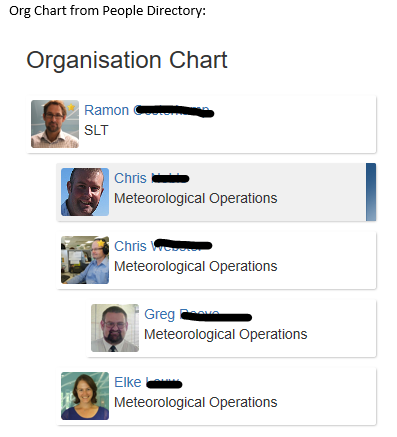

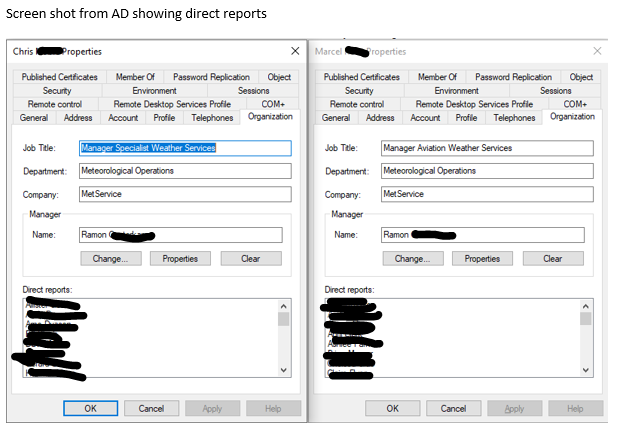

The first screenshot from AD shows Ramon has two direct reports, Chris N and Marcel.  The second screenshot is from the org chart in People Directory showing Marcel is missing.

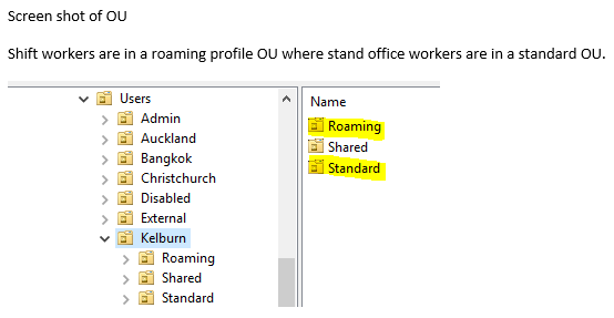

What you don't see is that in AD, Ramon and Chris N are set up as "Standard" users in Kelburn, whilst Marcel is set up as a "Roaming" user in Kelburn.
I can also say that if Marcel was set up in any other office (Auckland, Christchurch) he wouldn't show up, so the issue isn't that he's a roaming user, but that he's in a different OU at all.  We also have the exact opposite scenario - the manager is roaming and the employee is standard - with the same result.

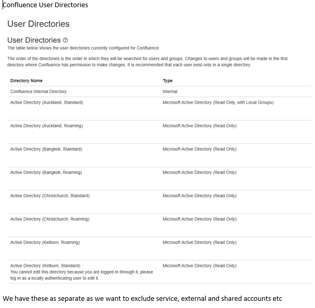

The infra team just told me they suspect the problem is with the way AD OUs are synchronized.  They don't sync at the top-level because that makes system/admin accounts visible.  Instead they synchronize by OU, which may be why Confluence can't connect a user in one OU with its manager in another OU.  (Though Exchange has no problem.)  We could sync at the first level (e.g. "Kelburn" which might help, but we still have the issue of managers in one division with reports in another office.

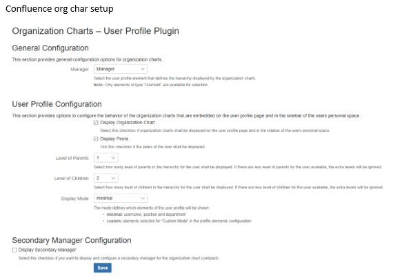

With this said, the organizational charts you are using is a marketplace add-on which is supported by a vendor. In order to figure out what is going on we will need to contact the vendor for further support. I have tagged the vendor of the add-on within this post. Along with doing this we would suggest you reach out to the vendor directly to get this resolve. You may submit a case to the vendor by Submitting a support Request. You also have the option to email the vendor at: products@communardo.de
There is also additional information within the documentation for the plugin which can be found here for the Administrator's Guide (v 2.1) and for the Organization Charts (v 2.1).

If users from the same LDAP directory are synchronized via separate directory configurations, references between them (by using the DN for a userfield) currently do not work.
We already have a feature request for this:
