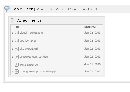

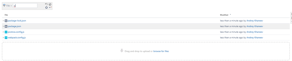

Andrey Khaneev _StiltSoft_
May 24, 2017
You can filter Attachments macro or Space Attachments macro with Table Filter macro: add free text filter for name (file) column and type in Fred.*PDF.
dan brown
June 30, 2020
Andrey, can you supply and example?
June 30, 2020
Please, take a look at these screenshots:
