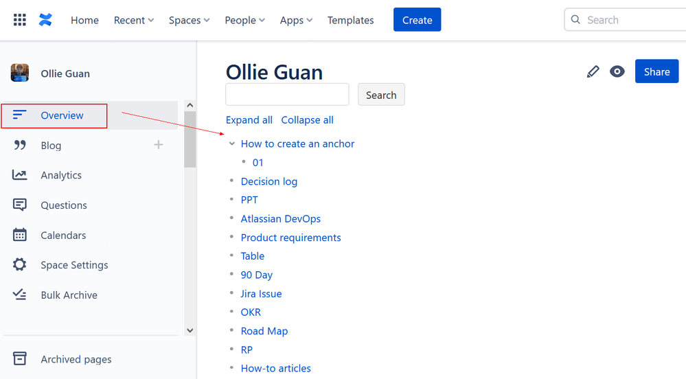

When we go to a space in Confluence, we are automatically taken to the Overview page, so I wanted to be able to display sort of a table of contents but for the whole space, so people can see what's inside and how they are related to each other.
Thanks for any advice and tips you can give!
Hi @Stefannie Tan ,
Add a search box as part of a dynamic page tree, which looks like a table of contents.
Insert the page tree search macro
