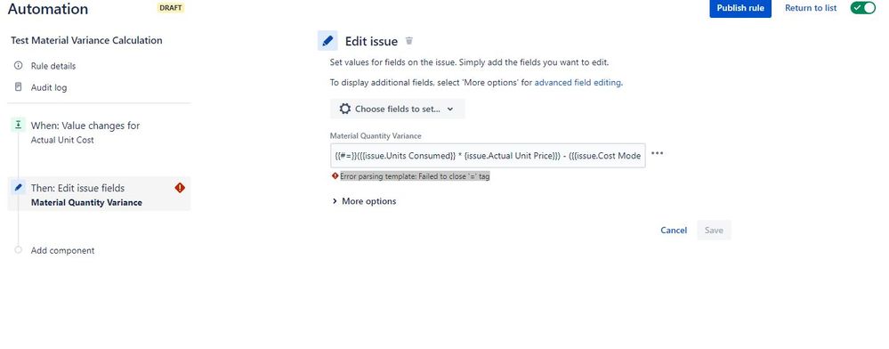

Thanks for the info Kian. When I am trying to publish the rule, it is returning the following error: "Error parsing template: Failed to close '=' tag"
Ah! My apologies. While I was typing it in I missed a "{".
It should be this: {{#=}}({{issue.Units Consumed}} * {issue.Actual Unit Price}}) - ({{issue.Cost Model Anticipated Units}} * {{issue.Actual Price}}){{/}}.
I'll edit the original answer to include the correct string as well!
