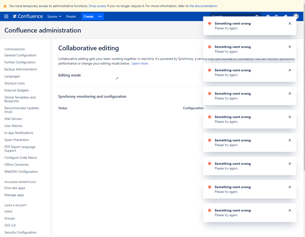

I can enabled Confluence Collaborative Editor Plugin, but can't get the configuration page to start the service.
It simply errors out, but not much information for troubleshooting.

What do you mean by "errors out", can you share a printscreen?

Sorry, the version was a typo, it is actually 7.1.0.
When I enable the plug-in and go the configuration page, it simply show like the screenshot, and I can't do anything about it.
When I check the log file, there was nothing about synchrony, and the service is not started.

FYI, it turned out that the above error was because the "Synchrony Interop Bootstrap Plugin" wasn't enabled.
Someone disabled the Collaborative Editing plug-in, which also disabled the Synchrony Interop Bootstrap Plugin, but when re-enabled the Collaborative Editing, it didn't also enable the Synchrony Interop Bootstrap Plugin, so it was left as "disabled"
After re-enabling the Synchrony Interop Bootstrap Plugin, everything now is working again.
