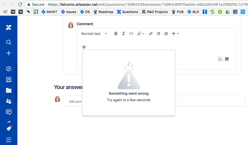

×This hapenned right after the update, some users can't use the @mention function at all - when trying to do so, they get an error message, I will attach a screenshot.

Use Justina.malciute/
1. Firefox - mentioning works
2. Google Chrome (incognito) - works
3. Google Chrome (normal window) - doesn't work

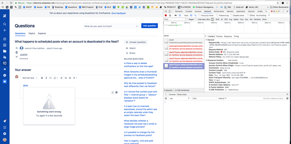

FYI - Cleared cache, didn't make a difference. This is a screenshot from the normal window usage:

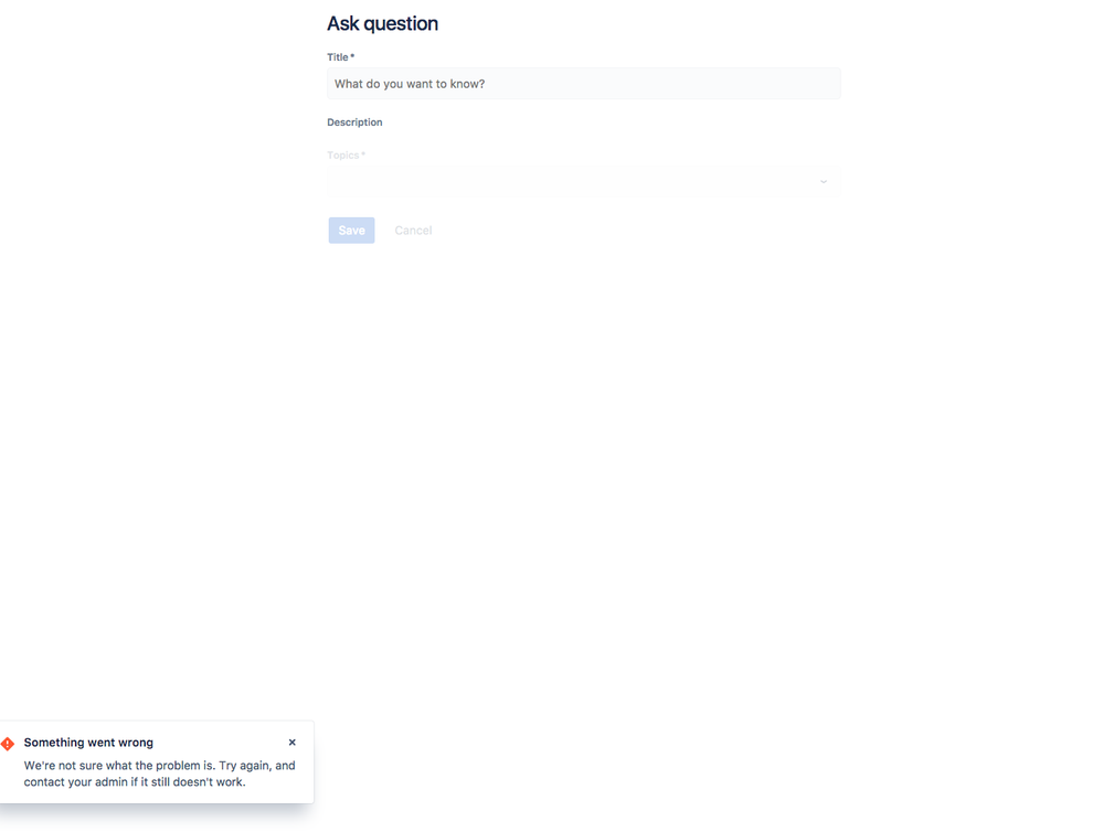

Also some of the users are experiencing this (can't save a Question, basically submit it):
User: gergo.szakony, camilla

Thank you - appears that for some reason Justina's browser is blocking the requests to our mention service. Can you confirm she has disabled all add-ons on Chrome? Would her network be blocking any of the following, by chance?
Regarding your 2nd issue, that should be reported as a new question or as a ticket in our support system.
