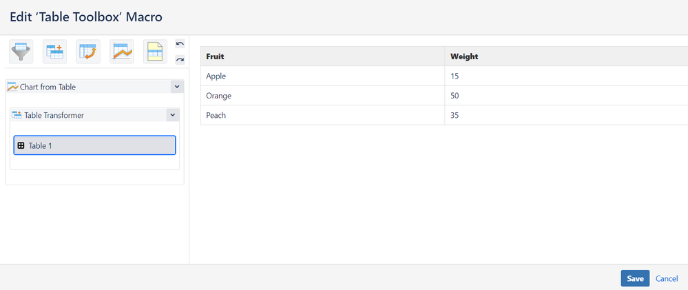

This is me once more time - I've consulted with our developers and understood that I've missed an obvious workaround for your case: please create a sequence "source table <- Table Transformer <- Chart from Table" inside the Table Toolbox macro.

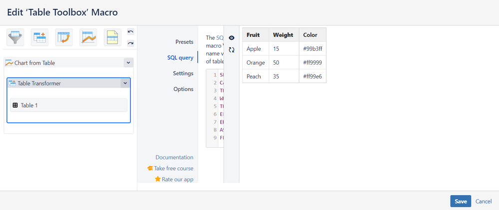

As you can see, we create a new column with HEX color codes based on the conditional formatting in the query:

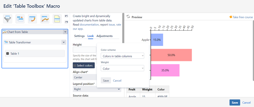

Navigate to the Chart from Table macro and use this new column to color your bar chart ("Look -> Select colors -> Colors in table columns"):
