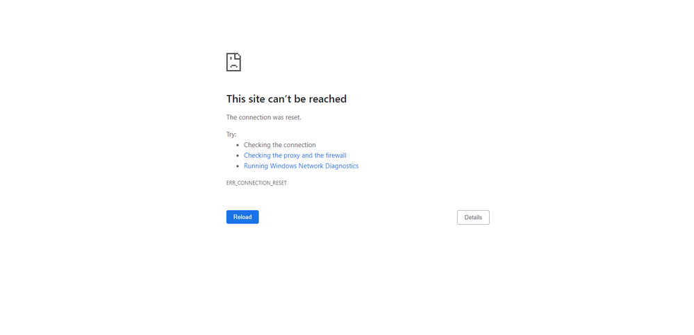

When we try to access the site-we get the message---site cannot be reached.

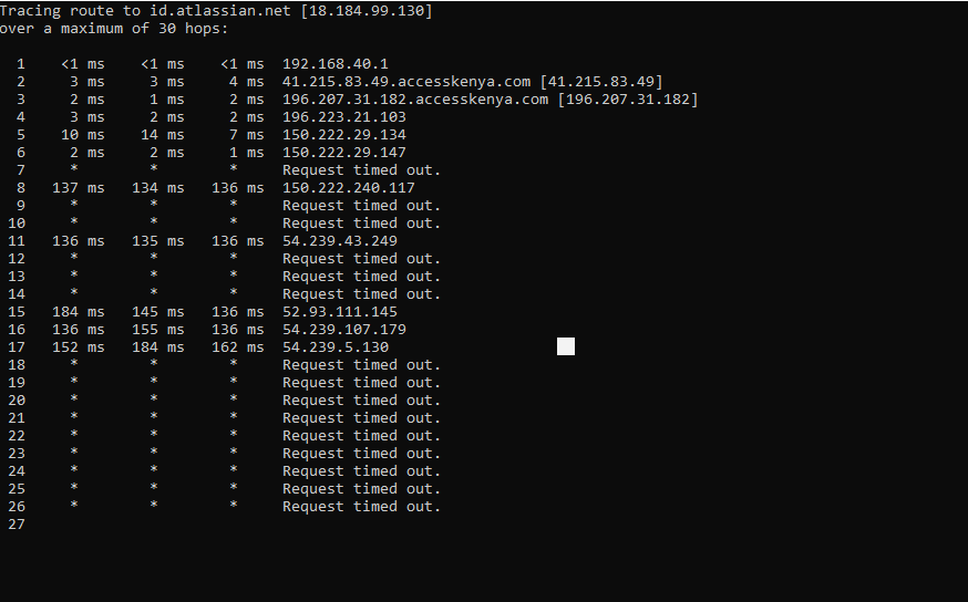

4. Traced the path from our network to the site itself. The results are attached error.PNG tracert.PNG
192.168.40.1---Firewall
ISP---Access Kenya
5. Escalated the issue to our ISP's to find out if the site is blocked, and also check if our public IP's have been blacklisted. Our ISP's confirmed that the site is not blocked on their end and our Public IP addresses have not been blacklisted. They asked us to check if the server hosting the atlassian site had blocked our Public IP's (197.248.212.41 and 41.215.83.49

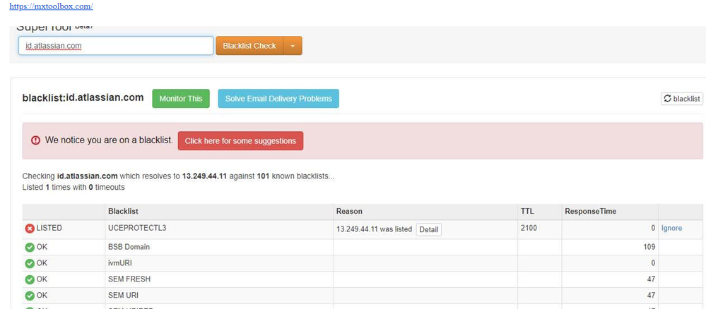

6. We also checked the site itself whether it had been blacklisted and we got the attachement
On relaying this information we got the reponse
he security team has checked the IP and though it's blacklisted shouldn't because of the problem experienced by the customer. This is because the particular blocked IP is used for email and not access site resources.

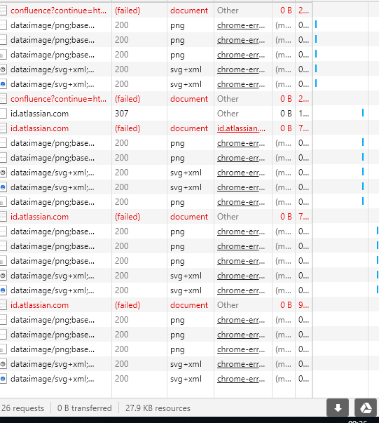

The Atlassian cloud support representative asked us to generate a har file and sharehar file.PNG

When I access the site using https://cupidmedia.atlassian.net/ it redirects me to id.atlassian.com.This is a case where you're signing up new users
In a case where the user has an existing account the url https://cupidmedia.atlassian.net, the user is redirected to Jira which works.
When I try switching to Confluence from Jira( https://cupidmedia.atlassian.net/secure/Dashboard.jspa)  I get a blank page
