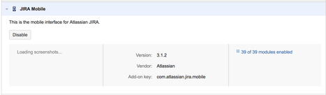

I would also check to make sure the JIRA Mobile module is enabled:

JIRA Mobile is enabled.
