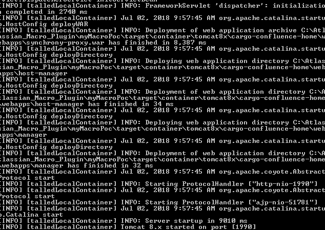

I have been through the tutorial creating confluence macro. Imported the project into Eclipse.. created the Java class required and And after build, install and run the plugin via
atlas-mvn eclipse:eclipse
then
atlas-run
it seems that confluence restart and should be available on 1990 port in my case http://NOM_MACHINE:1990/confluence and not http://localhost:1990/confluence

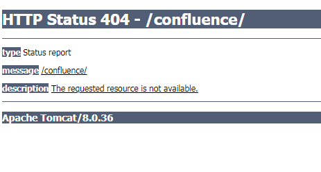

when I request it I got the error:
Anyone can help on this?

It seems strange to me but after following the tuto how to install Atlassian SDk + tuto How to create a Macro then currently what I have installed I do not have any confluence log. Even if Confluence was installed through the mentioned tutorials.
Nic Brough -Adaptavist-
July 5, 2018
You need to have a read of the Confluence application log - it looks like the Tomcat is starting up fine, but the plugin you have compiled is preventing Confluence from starting within that.  There should be details within the application log about that.
Julien Brachet July 16, 2018
Sorry but I cannot find any Confluence application logs. Shall I turn anything on? enabled log somewhere?

Julien Brachet July 2, 2018
in addition in the logs:
127.0.0.1 - - [02/Jul/2018:09:57:47 +0200] "GET /cargocpc/index.html HTTP/1.1" 200 124
0:0:0:0:0:0:0:1 - - [02/Jul/2018:09:58:38 +0200] "GET /confluence HTTP/1.1" 302 -
0:0:0:0:0:0:0:1 - - [02/Jul/2018:09:58:38 +0200] "GET /confluence/ HTTP/1.1" 404 1016
0:0:0:0:0:0:0:1 - - [02/Jul/2018:09:58:38 +0200] "GET /favicon.ico HTTP/1.1" 404 -
10.15.12.32 - - [02/Jul/2018:09:59:17 +0200] "GET /confluence HTTP/1.1" 302 -
10.15.12.32 - - [02/Jul/2018:09:59:17 +0200] "GET /confluence/ HTTP/1.1" 404 1016
10.15.12.32 - - [02/Jul/2018:09:59:18 +0200] "GET /favicon.ico HTTP/1.1" 404 -
