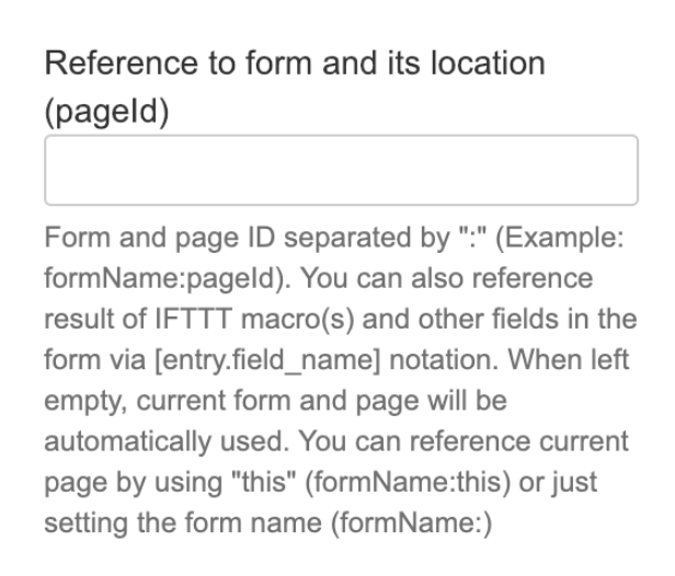

Alex Medved _ConfiForms_
October 15, 2024
You specify that in this parameter
In the format of
formName:pageId
