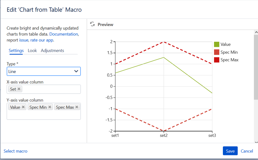

However, when I have two rows corresponding to the same Set my Spec line is broken.

Hi @Kai Winter ,
Seems that the behavior is correct: you can't have two identical numbers (values) on the axis. The graph is confused which "two" from which row we need to take.
In your Character column all your values are unique, maybe you can take them for X-axis instead of the Set column?
The same happens if I call my Set a different way
Also Spec Min takes the value -2, which doesn't exist in the table.
Is there a way to plot horizontal lines in a line plot additonaly to the main data?

Your idea to plot horizontal lines for the line chart is correct: just to use additional columns with the same values.
