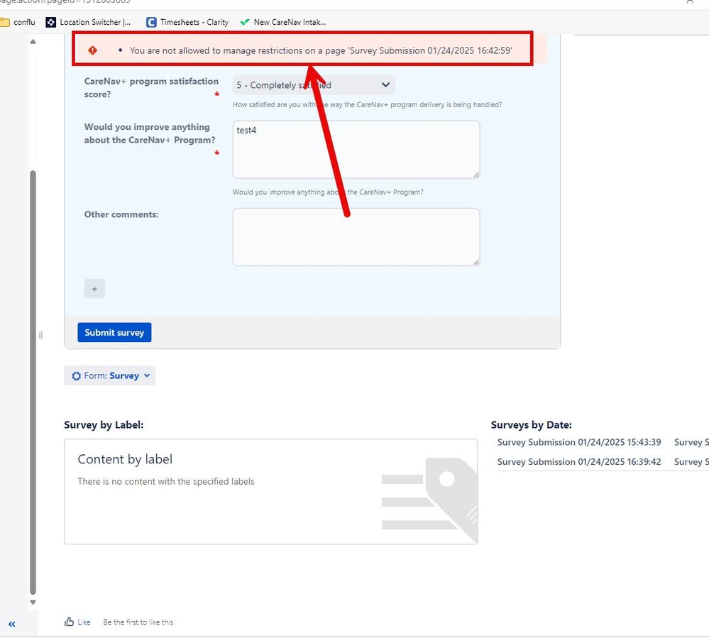

When a user tries to submit the 'Survey' form from on the parent page, they get the following error message (see print screen below)
Is there any way for the form on the parent page to impersonate the right level of permissions to run the "Restrict Page View" on the "OnCreated" event on a "Edit ‘ConfiForms IFTTT Integration Rules’ Macro" so the permission's on the child page can be restricted?

The fix you gave me is not working. I have included the macro code for you to try. Anyone who is not an admin is getting an error message and the child page restrictions are NOT being set.
User must be allowed to set/remove restrictions on pages in this space (Does not have to be an administrator).
Only this way it will work
