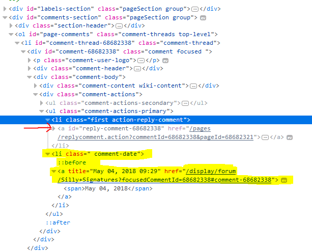

I was inspecting the page elements and noticed that the reply item is present, but not visible.
Please see below screenshot. Red arrow pointed to the hidden "reply" link. I have highlighted the date element which is showing as expected.
Do you have any suggestions of what could be making "Reply" invisible?

Can you expand the reply-comment div and paste the complete code here. Is there a css display tag in the div?
Can you copy the link in the href and access it in a new window? are you able to make a comment in this fashion?
Can you try to show it by force? Go to the browser developer console and enter $(#reply-comment-xyz).show();

Here is the expanded reply-comment div -
I'm logged in with different permissions, so edit and remove are showing, and work as normal.
I've tried browsing to "https://server/pages/replycomment.action?commentId=68682338&pageId=68682321" but it did not work. Should the format be different?
Maybe worth noting, I can reply to comments directly from notification email links.
In the console, I tried "$(#reply-comment-68682338).show();" but I'm getting illegal character errors. I pasted in hyphens to be sure. Not sure what else could be causing that error.
