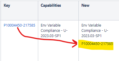

@Katerina Rudkovskaya _Stiltsoft_  - now I have another request:
How can combine column "Key" with column "Summary" and keep the Key URL hyperlink in the combined column?
Here are the 2 columns which I want to combine:
'Key' AS 'Key'
, FORMATWIKI("{cell:width=15%}" + 'Summary' + "{cell}") AS 'Capabilities'
Here is what I tried:
FORMATWIKI("{cell:width=15%}" + 'Summary' + "\n" + 'Key' + "{cell}") AS 'New'
But, I want to keep the URL for the 'Key':
December 13, 2022
Hi @Keith Lanier,
Try to replace your pluses by commas, it preserves initial text formatting:
FORMATWIKI("{cell:width=15%}", 'Summary', "\n", 'Key', "{cell}")
