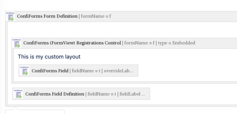

Your ConfiForms (FormView) Registrations Control macro must be inside the ConfiForms Form Definition macro in order to “define“ a default layout

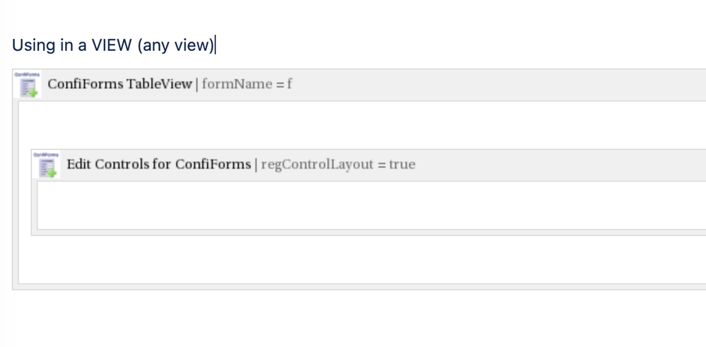

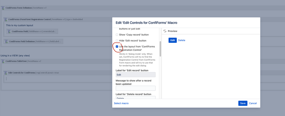

When that is the case you can then have a ConfiForms Edit Controls macro to have this option enabled
Here are some screenshots to demonstrate this visually using macro configurations
Alex

You should be able to point the Edit Controls to use the "Registrations Control" layout
True that it will still be presented in a dialog
