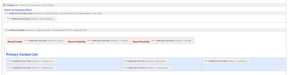

  1. I have a form w/50 fields.
  2. I wish to populate the data across 5 tabs (or expand box).
  3. Each tab will have 10 unique fields. (Ideally each tab will be list view).
  4. I am using ConfiForms Form Filter Control above an ConfiForms ListView.
  5. The Filter Control works properly for the single ListView for all 50 fields.
  6. However when adding Tabs 2-5 and populating the data with Form Fields (10 fields each unique to their own Tab) I only get duplicate data.... (same data as Tab 1).
Assistance is appreciated.

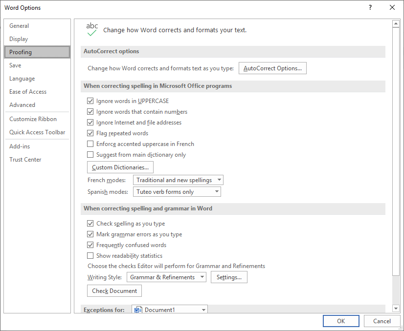

Related question.  I think/hope.
I have included an image of the MS Word Options dialog.  I would like to have Confiforms do something similar.  The user can select a tab (or expand box) and see that sub-section of fields.  The actual control is not as important as being able to see a subset without navigating to other pages.
I can get the fields on the first tab to populate, but not the second and additional tabs.  I have run out of ideas.  I believe that I do not correctly understand the differences/architecture to use JavaScript on the front-end vs. the back-end.
Links to documentation as well as any links to examples/samples would be great.

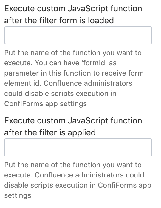

May 22, 2019
ConfiForms Filter macro loads / refreshes the contents dynamically via AJAX call. The contents of the view it is used to filter is rendered server-side.
If you have macros that require some custom initialization on the client side then these are not executed (unless the initializers are correctly added to the rendered macro and into AJS.toInit)
Alternatively, you can tell ConfiForms Filter to execute any specific JavaScript you may require by defining these parameters
