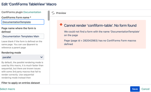

I would like to have a small form that is reused in many space pages and have all completed forms collate in a table on Page A (Documentation Templates Main) with the form fields as columns. I see you can do this and have the table show the results on the same page but need a collated version that shows all the result on another page.
I define the form on page B (above) and I try to collate them using ConfiForms TableView and input the page location in "Page name where the form is defined" I select the page suggestion I want- Page A (Documentation Templates Main). I get this error aler t below:
Can I not simply generate the form results on another page using the ConfiForms TableView? Am I doing this wrong?

Hi @Colin Roeke and welcome to this community
You have DocumentationTemplates (plural) form on the page A, but you reference a DocumentationTemplate form on the page B
Alex
Thanks @Alex Medved _ConfiForms_ Yes, you are correct about the "s". I corrected it and still not working. Maybe this process has been discussed and you could point me to the QA? I would think this is a common task and there would be a tutorial, but I have looked and looked with no luck. Maybe it is not common to reuse a form on multiple pages and have results collate in one table. Anyways, I thank you for any help/wisdom.

This is a core concept of ConfiForms... having a form definition (configuration) in one place and having form views and other views on different pages or spaces...
What is not working for you specifically?

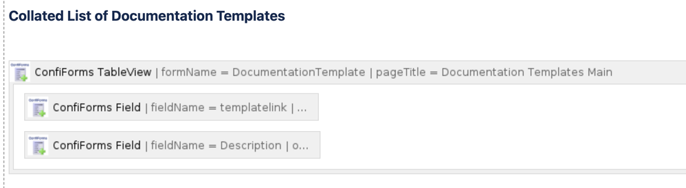

Here is a little demo (very simplified - only the basic parts)
Hope it helps
Alex
thank you so much for the demo! I had a few things mixed up- working for me now.
