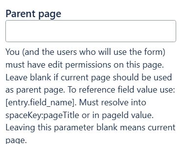

Hi @get_nick
Set the parent page (parameter in the ConfiForms IFTTT macro to "Crate Page") to the page id
This is the best approach (will work also when someone decides to rename a page, for example)
Alex

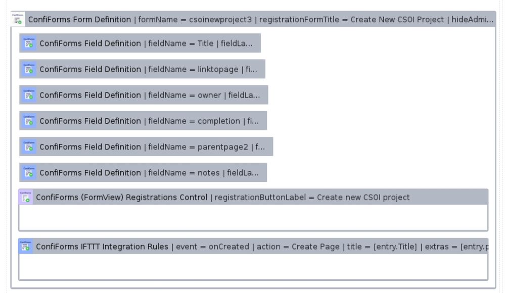

Ok, thank you. I'm starting to think I misunderstood the capability.
Ideally, when a teammate is submitting a form, they can select the parent page from directly in the form. Then the page would be created from that field they entered and submitted. This would prevent non-administrators from creating new Confluence pages that need to be moved to a parent page.
Is this possible? (example attached).
That is also possible
What is the name of the field for this "Parent Page2" field? And is it of type Page/BlogPost?
Ok, I think with your help, and a little dumb luck, I got it working!
Here's where I'm at. I had an extra macro I didn't need, (IFTTT move page), and updated the create page IFTTT to "[entry.parentpage2]" and it created it under the correct parent!
I knew I was close, thank you for the helping me cross the finish line!!!
Yes, having the [entry.parentpage2] in the "Parent page" parameter would be correct
