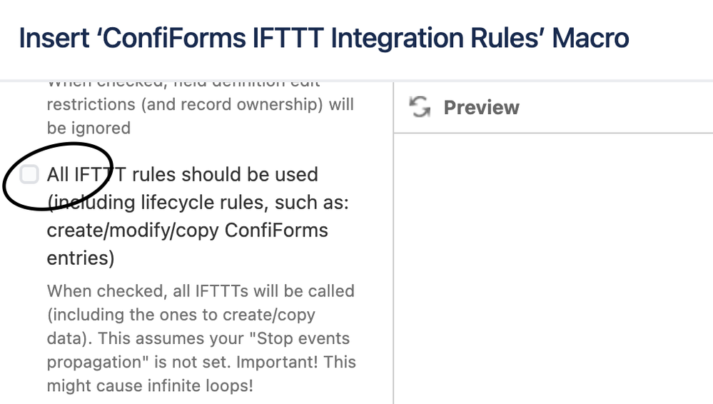

I don't even know whether what I am trying to do is possible, but there it goes.
Consider you have two forms.
On the first one, I have defined one IFTTT triggered on modified, that updates entries by filter. It has been set up like a father-child database, with a second one that has multiple entries sharing a field key with the first one.
Ok. What I want to get is that all the records on the second form sharing that field with the first form were updated with the IFTTT triggered.
Well ... that is working really well. but ... where is my problem?
In the second form, there's some other IFTTT defined, but I can't make the form triggered those other IFTTT (most of then on Modified events). I thought that, as you update entries, those IFTTT should be triggered too. Is that even possible or am I doing something wrong?

Hi
You need to explicitly say to run ALL the IFTTTs when you want to do the cascading...

Sopaboba October 20, 2021
Thanks again. Problem solved. As always, Alex
