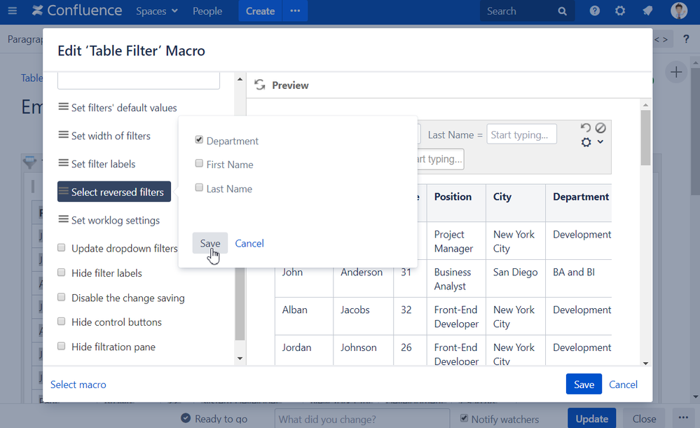

You can filter rows not equal to selected values with the help of the Table Filter macro of the Table Filter and Charts for Confluence app.
Wrap your table with Table Filter,
 switch to the Filters tab, select the dropdown filter column and add values (text1, text2) to it, then switch to the Filtration tab, click Select reversed filters, define the filter to operate in the reverse mode.

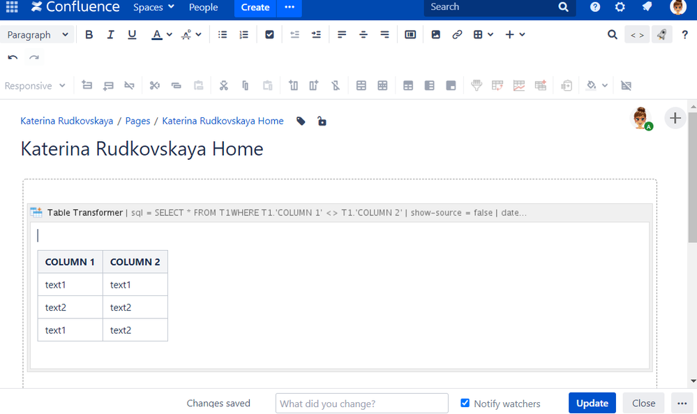

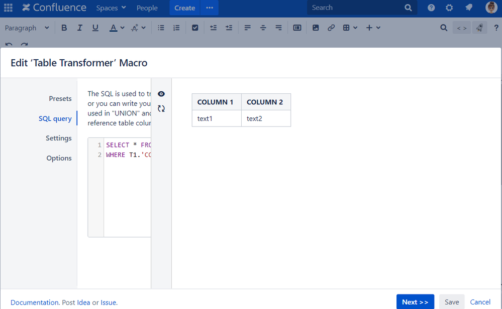

I think I've got what you need, please try our Table Transformer macro in your case.
Wrap you rable with it and use the SQL query like this:
SELECT * FROM T1
WHERE T1.'COLUMN 1' <> T1.'COLUMN 2'
Best regards,
Katerina
