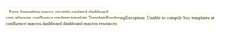

I have now reduced my user count to under 10 so that I can apply a full 10 user license. This has not fixed any issues. I have the following shown on the main screen:

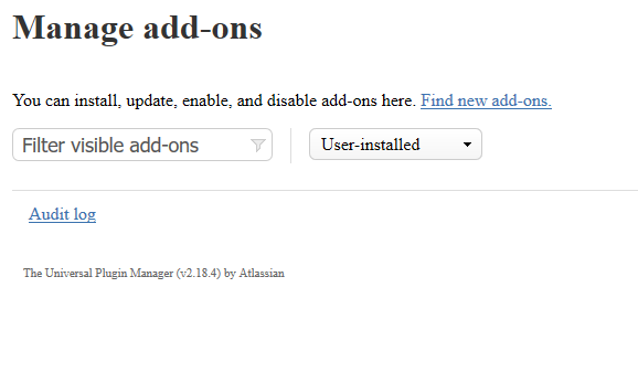

If i try to manage add-ons I get this:
None of the add-ons are shown so I can't do anything to get them going again.
I have tried re-installing confluence in case there are some broken files. I have tried deleting the plugin cache folders and restarting.
This getting frustrating as users are now unable to access important information.
Check if the all directory/folder structure is owned by Confluence user and has correct permissions. Also check Confluence user or user running the application has permissions to run the application.
Also it is better if you refer logs, you will see more details. Do you see any errors in logs?
If nothing works, good idea to contact Atlassian support so they can go though all logs and support zip.
I think (hope) that making sure that the folders were given different permissions has solved the issue. After a server reboot it now appears to be operating correctly including being able to create pages.
