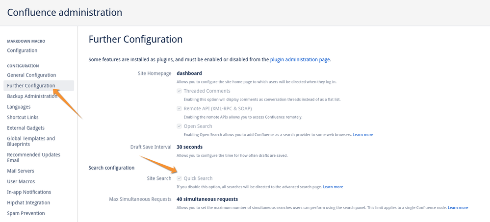

Hi @boris11 May be you have already checked this, but just want to confirm if Auick search is enable for the instance as shown below
If so, Please check the below Atlassian KB article if this is the issue in your case.
https://confluence.atlassian.com/confkb/searching-using-quick-search-does-not-work-432803231.html
