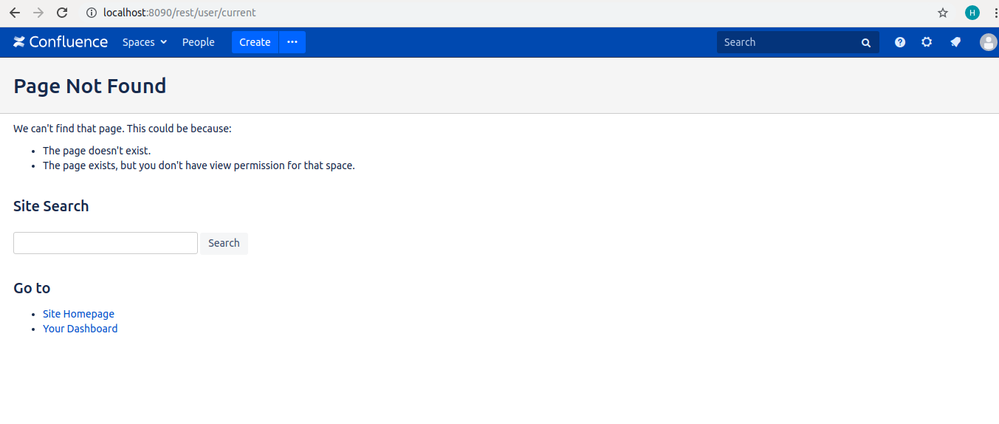

@Thomas Deiler All of these URL's are returning what I show in the image below. I am not getting an error. The page loads just the content on the page says the page is not found. The same information is returned with my cURL call in code. Is there something that I have to enable to make rest calls? The account that I'm using to access this information is a system admin. I just installed Confluence yesterday to do some testing on my own. Confluence version is 6.8 and it run on MySQLmissinginformation.png
Thomas Deiler
July 31, 2019
Dear @Harvey Bennett ,
possibly the REST API is disabled. Have a look at this page to double check.

Harvey Bennett
August 1, 2019
@Thomas Deiler I didn't realize the API was disabled by default after it is installed. I should have checked before asking! Thanks for the insight :)
