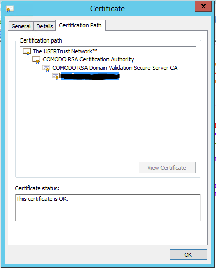

Kevin Decker February 14, 2018
I've acquired an SSL cert for our confluence instance (Windows server 2012) and I'm having some difficulty with installing it. I've gone through the documentation on here but we still run into an issue where the site is not secure. Any ideas? Here is what the cert looks like. confluence.PNG

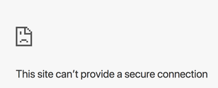

I went through the process of importing the cert & then I imported the root & intermediate certs as I saw in some of the documentation. After doing so I made the changes to the base url and the xml as documented and restarted the instance. When trying to navigate to the https link we get the below message. Screen Shot 2018-02-14 at 10.59.38 PM.png

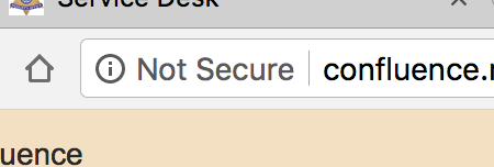

However navigating to the http link does work but displays the messaging below
