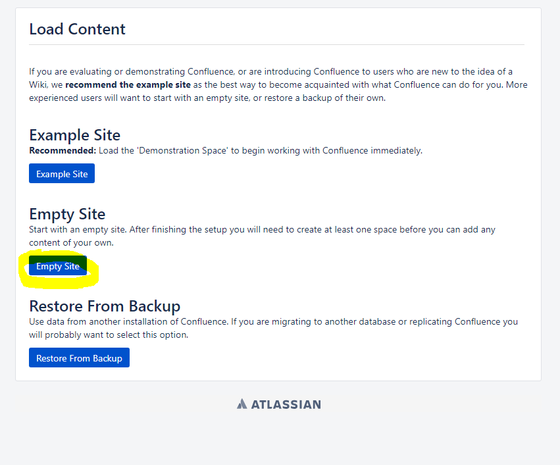

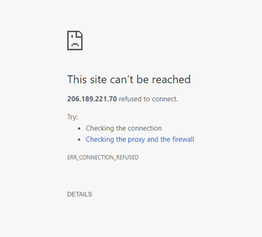

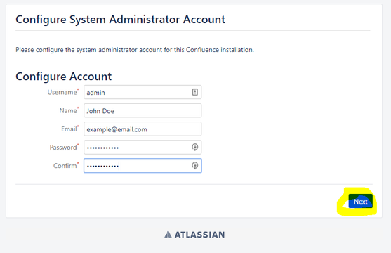

I am currently installing Confluence server on Ubuntu 18.04 LTS x64 hosted on DigitalOcean. I am using MySQL for the database. The setup process is successful all the way until I click on "Empty site." It asks me to create an administrative user, which I do, but when I click on create Confluence crashes. I have Confluence set up as a service with default settings for port, installation directory, etc. The code I used to install confluence and set up the database can be found here: https://github.com/mtnbikerjoshua/confluence-installer-ubuntu.
