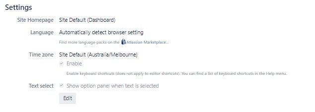

where my date range is between the given criteria and in tables the date looks like the other screenshot attached. Regarding location, I checked my system and I am attachingconfluence date format.jpgSettings.jpg the screenshots for the same.
Stiltsoft support
September 18, 2024
As I've said before, ' '  are used when you call out column names. When you refer to strings, you need to use " ":
"01 Oct 2024" AND T1.'Date Contract will Expire' <= "31 Dec 2024" THEN "FY25Q1"
And again make sure that you have a proper date format inside the Table Transformer macro settings: the "01 Oct 2024" corresponds to the "dd M yy".
MudCo
September 20, 2024
perfect! I checked my settings and it was not in "dd M yy" form. And I changed the ' ' to
" ". Worked perfectly. Thanks so much for your help!
