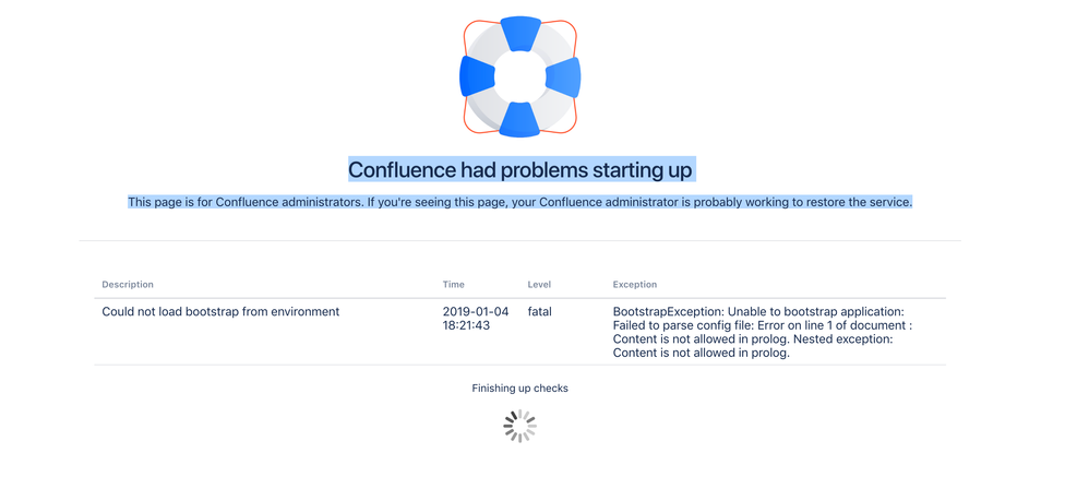

We are getting an Error which we try to access our Confluence System
Our Confluence is Hosted on our Local System and was working well before today.
When we try to access we are getting below message from Confluence
Nic Brough -Adaptavist-
January 4, 2019
Someone edited the config file after the previous time Confluence was started.  They've corrupted it and it's no longer valid, so this time when you try to start it, it is failing.
You will need to repair the config file it is telling you about and restart.

I doubt that some has done any changes but still let me know the location for the Conf file so that I can review the file.
January 4, 2019
I have no idea - there's a lot of config files.  Your screenshot seems to have lost the file it is complaining about.  If it was not the screenshot being trimmed, then your next step is to read the confluence log to see what the file is - should be <confluence home>/log/atlassian-confluence.log
