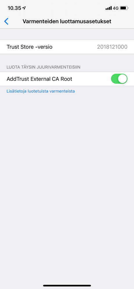

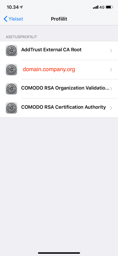

I'm trying to get the Confluence mobile app working on IOS12 device. I followed the guide at https://confluence.atlassian.com/confkb/can-t-get-a-secure-connection-error-on-confluence-server-mobile-app-940695063.html?_ga=2.159807226.617285392.1547551120-1779767841.1539165495 without success.
I'm not that familiar whit the certificates - the certificate for the confluence server includes 4 files. I installed all of them as profiles and then enabled "AddTrust External CA root" from ios certs - but still i get the same error.
