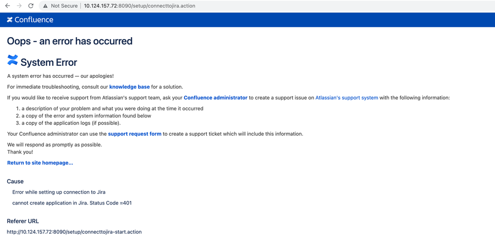

Also, now, both jira and confluence seems to be broken as you can see:
http://10.124.157.124:8080/
http://10.124.157.124:8090/
What would you suggest next, because we are not able to login to the jira website anymore and this is what my confluence page throws up. attachedScreenshot 2023-04-24 at 8.24.29 PM.png

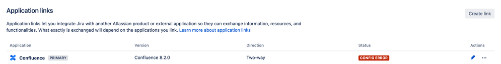

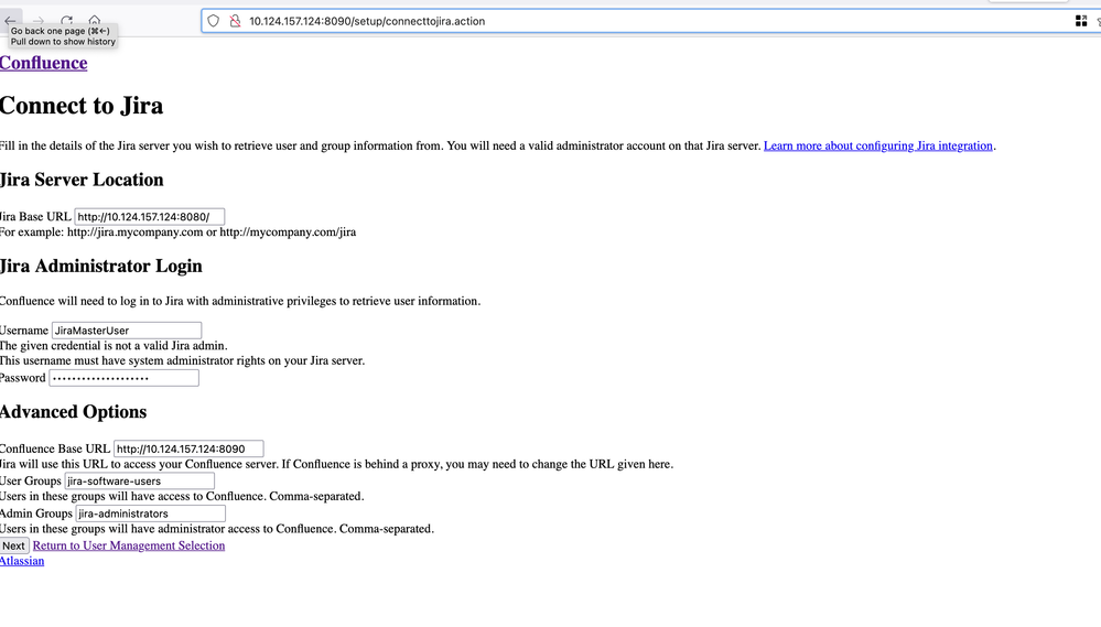

I tried following the above link related to linking the application and seeing the below error:
We can't connect with Confluence because a reciprocal application link is missing on that server. You'll need to delete and then re-create this application link
Screenshot 2023-04-25 at 9.13.28 PM.pngScreenshot 2023-04-25 at 9.17.45 PM.png
