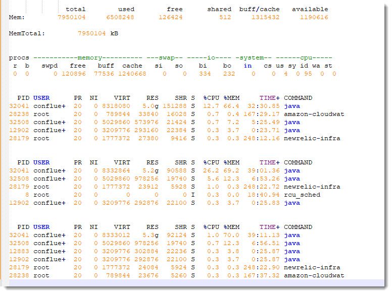

Here's a snapshot of several pieces of information I got from the command line. The ones at the bottom of the page are the output of 'top' at several different times.

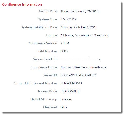

Here's the config page (blanked out the server base url just in case I shouldn't be sharing that)

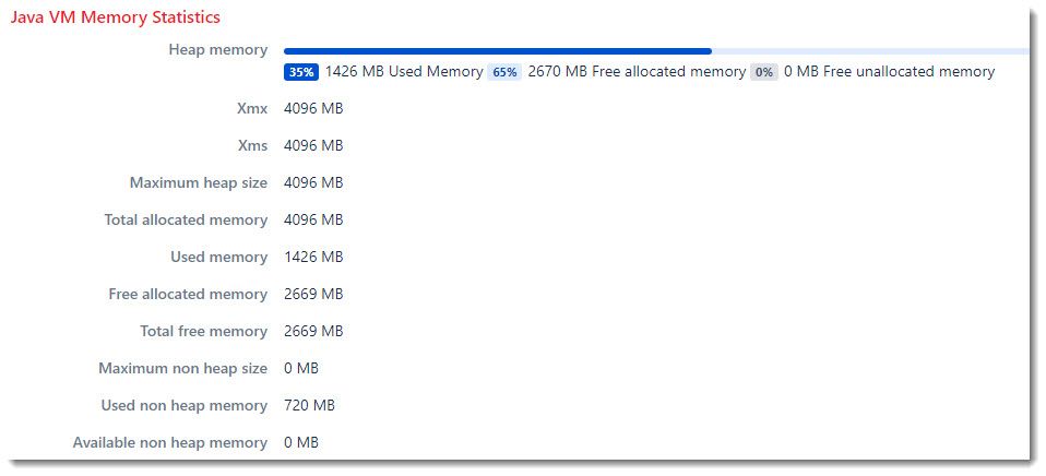

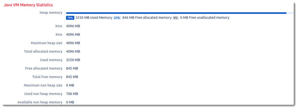

And here are 2 different points in time ss of the memory stats in confluence:
