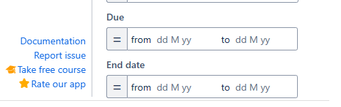

I am using Jira issues macro inside Table filter and have issue to properly filter table. Date format in Jira is like 08/Apr/25 . I am not sure what date format to use in the filter in order properly do filtering. I tried also with Table Transform, but result is the same.
In a dropdown filter of a macro I am not able to recognize this date format. Probably I missed something but need your help on how to set this right.

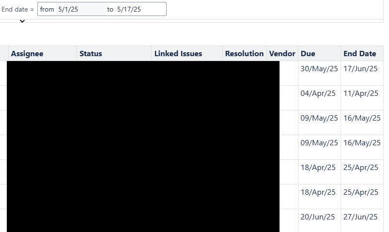

Have you adjusted the date format when setting the Date range filter? Your filter shows 5/17/25 that is m/d/y and the format in your table is 18/Apr/25 that is dd/M/y.

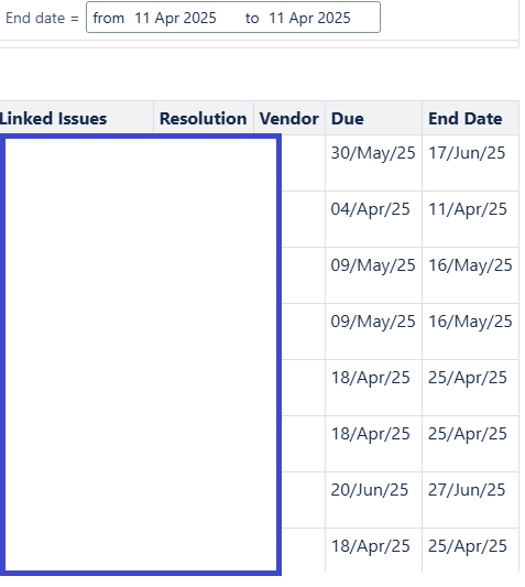

Here is how I set the filter:
And here is result:
It seems to me that there is no corresponding date format in filter macro for the one used in Jira: e.g. 08/Apr/25. Am I right?

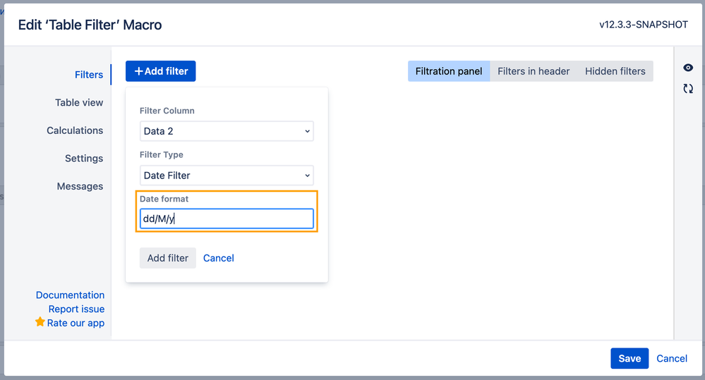

When you add the Date filter to the column, it prompts to type in the required Date format. As you have dd/M/y format in the original table, you should enter this format in the field.
Nenad Ristevski April 8, 2025
Oh, my bad! Of course, this works! Thanks a lot!
