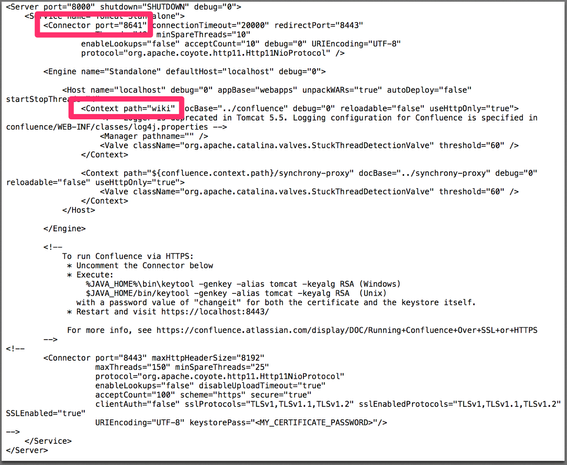

Now, I'm not sure which version of Confluence you are installing, but have a look here at my conf/server.xml file from my 6.4.1 installation:
You can see I changed the port 8090 to 8641, so make sure that you still have 8090 next to that connector port if that is the port you want to use. You also want to make sure nothing else is running on that port, or that you don't have another Confluence instance running on the 8000 port, if you had multiple set up.
Additionally, that context path will be blank by default, and just show "" meaning you can only load at localhost from that port. so localhost:8090, for example. If you have Jira *and* Confluence running then you will want to set a Context path there. This would then be "confluence" since that's where you were trying to open Confluence. So please compare what you're using with this file.

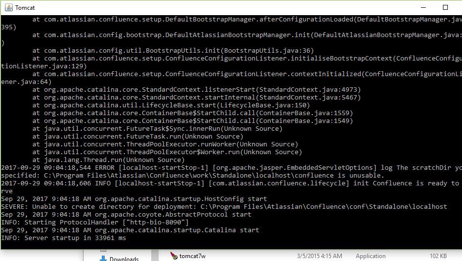

Now I get:
HTTP Status 500 - java.lang.IllegalStateException: Spring Application context has not been set
And there were errors when I ran start-confluence
"Failed to create work directory" doesn't sound good.

Hi Gabriel,
At least we are getting closer! Can you try having a look at this:
The scratchDir specified is unusable
It seems the home directory you specified is having issues being created, most likely due to permissions. That article will help you to correct them.

That was it. Though I'm a local administrator, I went all out and set all users to full control (not just modify, though I'm sure modify would have done the trick). I'm in!
Thanks so much for you help. If you hadn't told me about the BIN folder, I never would have found that error message to google, which led me to permissions.
