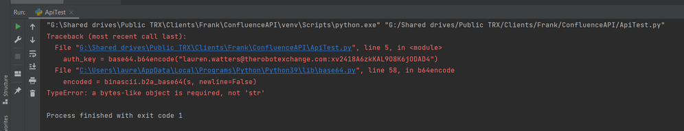

I tried the code you showed exactly and checked it a few times, however I was granted with an error message which I will show below and im not sure why. If you have time to review the code and see where I may have gone wrong that would be great. (I didnt include the API key this time as I have learnt from your previous message):
import base64
import requests
# The string we're encoding should be "<your-email>:<your token>"
auth_key = base64.b64encode("lauren.watters@therobotexchange.com:api-key")
print(auth_key)
# Using the base64 encoded auth_key string from above
# The "Basic " (including space) is important
headers = { "Authorization": "Basic " + auth_key}
# Fire your request, attaching the authorization heade
response = requests.post("https://admin.atlassian.com/s/3264ff5d-6218-4e57-a69a-894f103a800b/content", headers=headers)
print(response.status_code)
if response:
print('Request is successful.')
else:
print('Request returned an error.')
This left me with the following error:

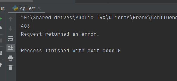

I thought of a way round this by using an online encoder for the email:api-key, and used the following code below. But this then returned the 403 forbidden status code once again. Im really not sure as to why I cant seem to grant access to the confluence account to be able to pull the required data from this.
import base64
import requests
# I have edited the auth key by removing parts, left it in to show as an example
auth_key1 = "bGF1cmVuLndhdHRlcnNAdGhlcm9ib3Rl-----------api-key----------Z6a0tBTDlPOEs2ak9EQUQ0"
headers = { "Authorization": "Basic " + auth_key1}
# Fire your request, attaching the authorization header
if response:
else:
If you have any ideas as to why this still isnt giving me access that would be great. Im really unsure as to where to go from this.

I should've noticed this earlier, but I think the problem you may be facing now is that the admin.atlassian.com URL you're requesting is not a valid part of the API. I just tried a similar URL myself and got the same 403 result. You would need to use one of the functions described in the Confluence Cloud REST API documentation. Each function will have 3 important parts: the URL, the "method" (in your case it will usually be "GET"), and the parameters.
For example, to get a list of content from therobotexchange Confluence, you would use GET /wiki/rest/api/content:
response = requests.get("https://therobotexchange.atlassian.net/wiki/rest/api/content", headers=headers)
(Assuming your Confluence site can be found at https://therobotexchange.atlassian.net/wiki)
