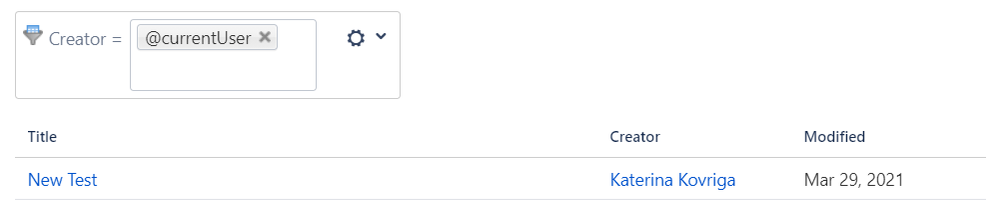

Is there a way to set the macro Content Report to display the current user?
Meaning that I would use it to display only the tasks assigned to the one who see the macro.
That would be super helpful.
Cheers.
You may use the Table Filter and Charts for Confluence app to filter you Content Report Table macro - just wrap the macro into the Table Filter macro and filter the Creator column by the @currentUser:

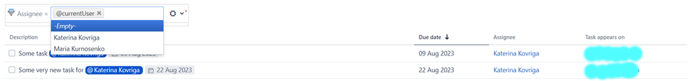

If you want to filter the Task Report macro (you've mentioned tasks in the second part of your question), it has a limitation for the Server/DC version due to the built-in macro pagination (see this question for the details). We've added your vote for the ticket in our backlog.
I actually would like to filter the Task Report macro records for the current user on DC (version 7.19). Has that issue been resolved? I have wrapped the Task Report (for completed tasks) in a Table Filter macro and attempted several SQL functions, to no end.

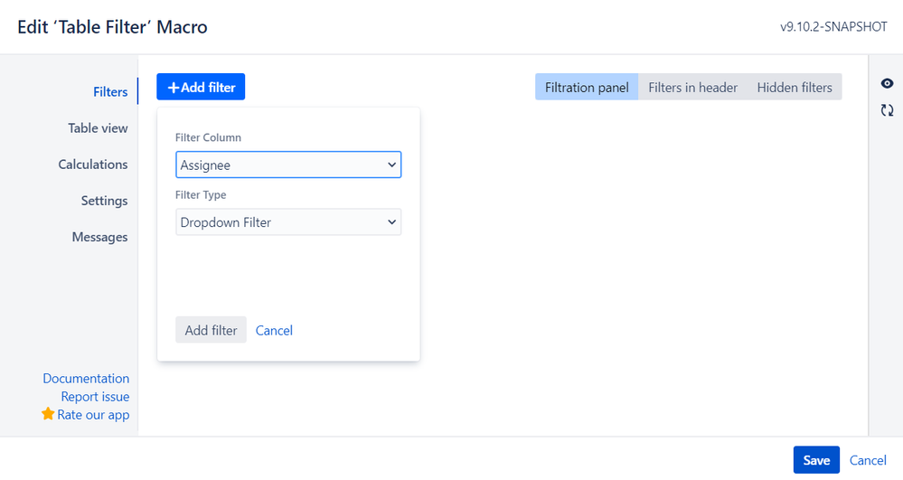

Hi @Kim Trask ,
Not sure what issue we are talking about, the Table Filter and Charts for Confluence app always supports three Confluence hostings: Cloud, Data Center and Server.
Also you are not supposed to use any SQL functions within the Table Filter macro to filter your report by assignees: just wrap your Task Report macro in the Table Filter macro and set a dropdown filter for the 'Assignee' column.
Hope it helps your case.
This was resolved as best it could be on a different thread using @currentUser to filter the entire table of issues instead of only a column. Still not optimal, but it works given our use-case.
