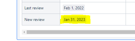

Hi Stacy,
As a workaround without coding: you could enter a task with add a date, like this:
If the date is in the past, if will be displayed in red.
Hope that helps,
-Stefan
Stacey Ropiha May 31, 2022
Stefan, thank you soooo much, that works!! So simple :) appreciate your reply, again thank you
