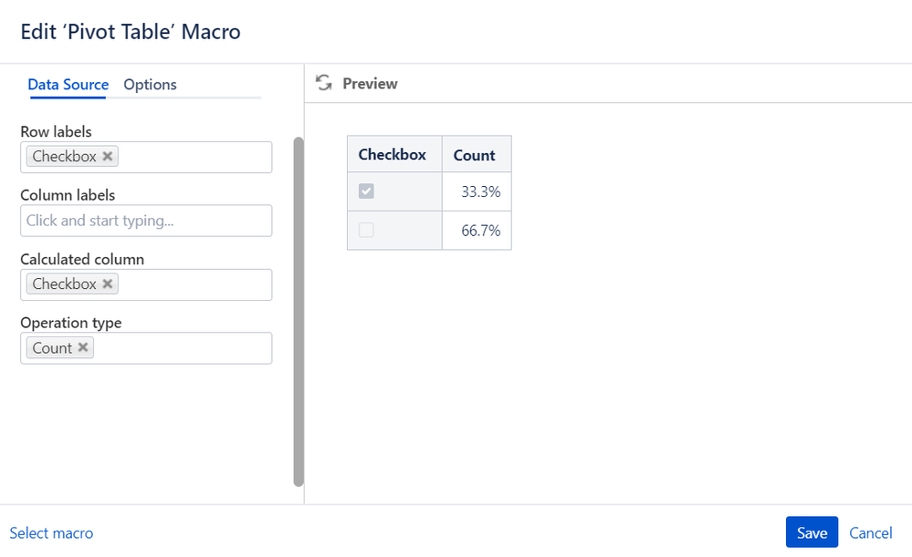

Hi @John McLoone ,
You may use the Table Filter and Charts for Confluence app for the case: its Table Filter and Pivot Table macros understand the checked and empty checkboxes.
So, you'll be able to create pivot tables with percentages that may look similar to the screenshot below:
Here we talk about native Confluence tables, but if you still prefer to use spreadsheets, you may try the Table Spreadsheet macro and get the Excel-like functionality right in Confluence. This macro is also provided by the Table Filter and Charts add-on.
