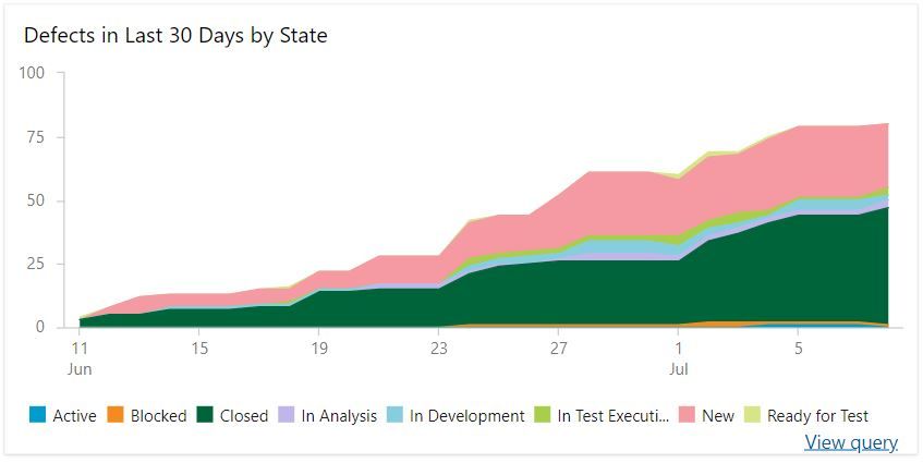

I want to create a chart out of it, that would look a lot like this (ignore the data and dates in the following chart, it's just to make the example):
I can't see a way to cumulatively keep a count of items in a given state, across a given time frame. I'm getting some odd results where the Stacked Time Area chart is just totalling up numbers of issues per day, and also not recognising or showing the different State values (is this because it is text and not numeric)?

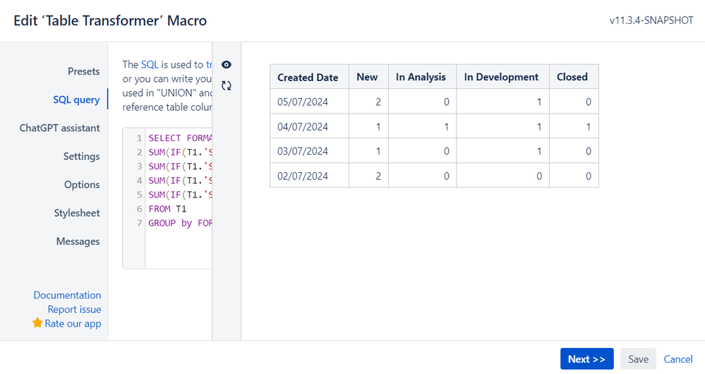

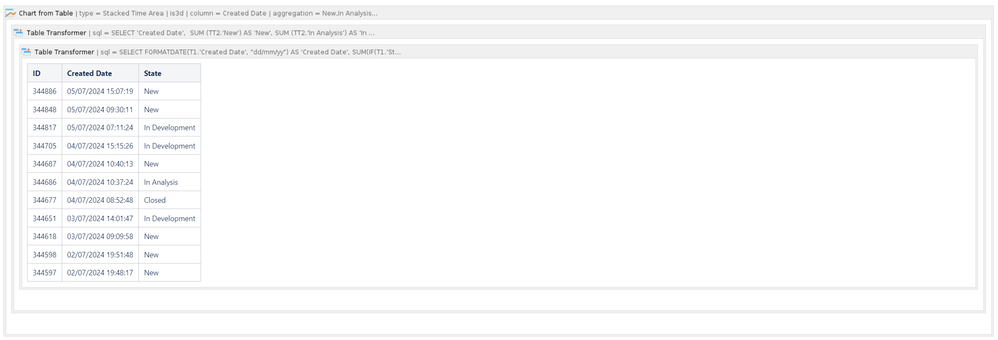

For example, for your case you may use the following structure:

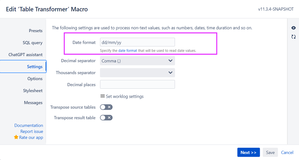

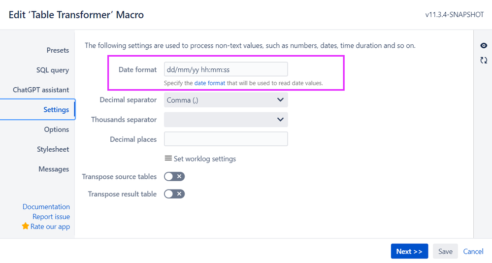

Then you may go to the documentation and calculate your statuses in the internal Table Transformer macro: https://docs.stiltsoft.com/tfac/dc-server/custom-transformation-use-cases-with-advanced-sql-queries-42241587.html#CustomTransformationusecaseswithadvancedSQLqueries-Countingthedefinitevalueinacolumn
SELECT FORMATDATE(T1.'Created Date', "dd/mm/yy") AS 'Created Date',
SUM(IF(T1.'State' = "New", 1, 0)) AS 'New',
SUM(IF(T1.'State' = "In Analysis", 1, 0)) AS 'In Analysis',
SUM(IF(T1.'State' = "In Development", 1, 0)) AS 'In Development',
SUM(IF(T1.'State' = "Closed", 1, 0)) AS 'Closed'
FROM T1
GROUP by FORMATDATE(T1.'Created Date', "dd/mm/yy")

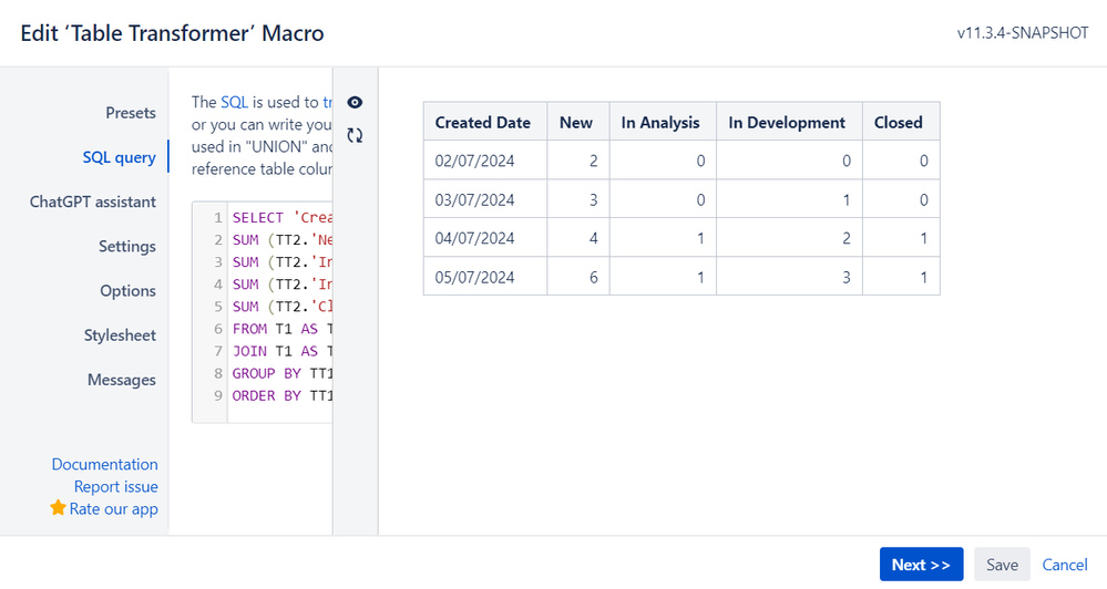

Then you may visit the documentation once more and count your numbers cumulatively in the external Table Transformer macro: https://docs.stiltsoft.com/tfac/dc-server/custom-transformation-use-cases-with-advanced-sql-queries-42241587.html#CustomTransformationusecaseswithadvancedSQLqueries-Calculatingcumulative(running)totals
SELECT 'Created Date',
SUM (TT2.'New') AS 'New',
SUM (TT2.'In Analysis') AS 'In Analysis',
SUM (TT2.'In Development') AS 'In Development',
SUM (TT2.'Closed') AS 'Closed'
FROM T1 AS TT1
JOIN T1 AS TT2 on TT1.'Created Date' >= TT2.'Created Date'
GROUP BY TT1.'Created Date'
ORDER BY TT1.'Created Date'

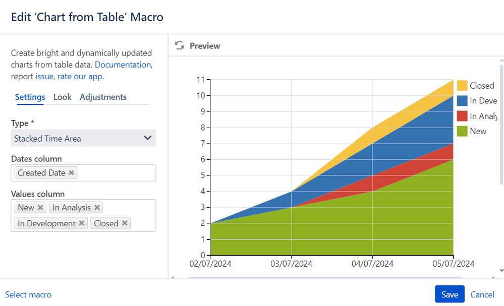

Now you may go to the Chart from Table macro and choose the Stacked Time Area chart type:
The X and Y scales' step is set to 1.

That all works perfectly and was really well explained. I really appreciate this.
I also learned that the order of adding the value columns to the chart is importantly too. Some of my earlier trials had the widest sandwich layer ( the Closed items) topmost, while it is actually better to order these as the bottom layer.
