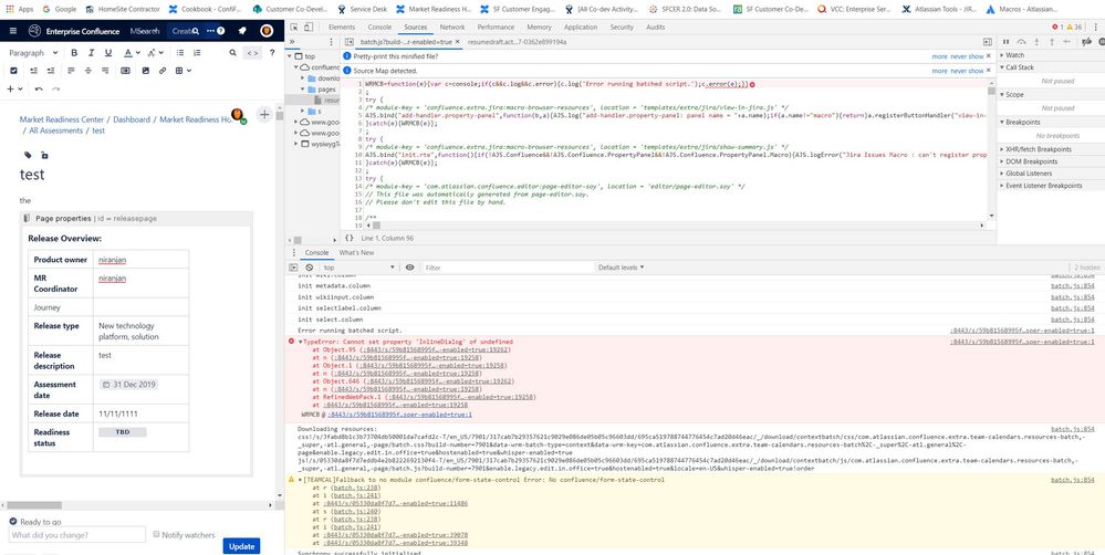

Yes, It showing only one error - "TypeError: Cannot set property 'InlineDialog' of undefined".
Davin Studer
September 12, 2019
I don't see any calls to InlineDialog in your code above. Is it being called elsewhere without a try/catch block? If it fails then your code may never run. You should be able to click the error and find out where it is being called.
niranjan September 12, 2019 edited

On the sources tab you should be able to see the code for the Confluence page. I would then do a search and find the spot in your page where the JavaScript is inserted. Then you can put in break points and walk through your JavaScript. If it is your script that is causing the issue then you should be able to see that by walking the script. If it errors before even getting to your script then you will need to look elsewhere for the issue.
