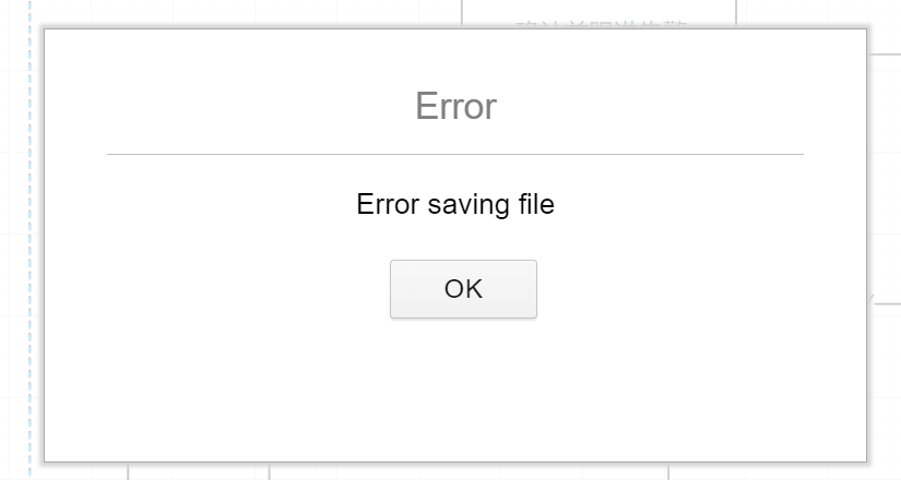

I have a confluence server hosting in Azure Linux VM and running for 2 years already.  And I reboot it last week due to Azure maintenance. After reboot, I get the error message "Error saving file" when I create a new diagram by the Draw.io plugin.
The error message is as below:
And I checked the console from both Chrome & Edge, they are returning a 500 ERROR from the backend.

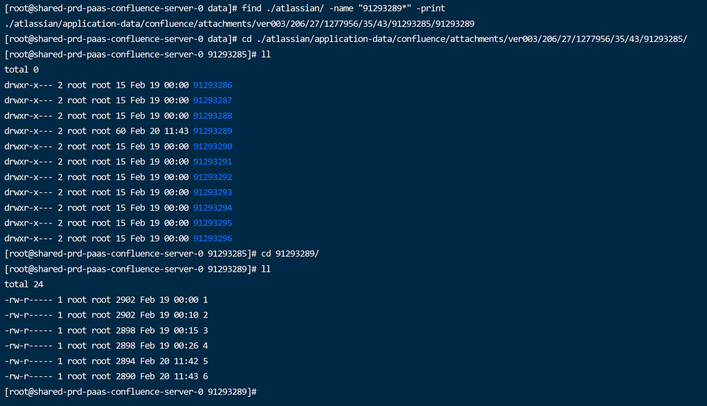

It looks like the server is not able to save new XML files by Draw.io but I checked all-new XML created by draw.io has been saving into confluence server under /data/atlassian/application-data/confluence/attachments/ver003/206/27/1277956/35/43/91293285
The new file has been created in the server:
So, I am not sure why confluence returns "Error saving file" on Draw.io UI.  Can someone answer it for me? Thanks.
