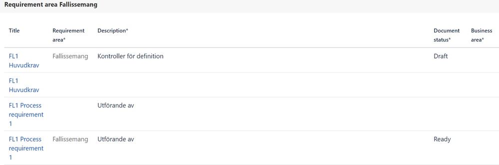

When I create a page property report I get duplicated rows and I don't understand why that happens. The two first rows have links to the same page. Do somebody have a clue what I could have done wrong?

I have seen this happen when there is more than 1 page properties macro on the source page. You might try adding an optional page properties ID to the page properties macros that you want to report on. You'll also need to add this ID under Options in the page properties report macro itself.

Page Label and Page Properties ID have been set. I find it interesting that it is not every page that has a duplicate row. The only thing that I can think that might have caused is using the right+click rename option.

UPDATE: I feel a little silly now. This was caused by the table somehow being duplicated at the bottom of the "duplicated" page.
