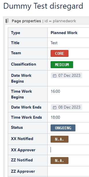

So, I have a template used for posting Planned work. Its inside the Page Properties and I have a nice dashboard that shows me the results. As you can see I am using the Easy Dropdown macro. Also got the Table filter and Charts for Confluence macro installed.
I would like the table to be more dynamic. So. let's say you choose "N.A." in one of the dropdowns then I would like the field below grey out. Or also I would like to know how I can have dynamic text / dropdowns appear in a cell based on the value of the dropdown. Been trying to use the table transformer, but have not quite succeeded.

Thanks, I got as far as this in he Table Transformer:
SELECT T1.*, FORMATWIKI(" {cell}", CASE WHEN T1.`Planned Work` = "N.A." THEN "Not Applicable" ELSE T1.`Planned Work` END, " {cell}") AS `Planned Work` FROM T1;
However, this overwrites the cells with "N.A." with Not Applicable rather then inserting it in the cell directly below which is what I am trying to get it to do. (fighting with GPT3 and 4 on the side here :-))
While working with the Table Transformer macro you should understand that it treats your source table as a mini database, you refer to column headers and color cells (set statuses, etc.) accordingly to their contents.
As I see it, you collect your Page Properties as vertical tables. Your headers take the first column.
The same structure remains for your Page Properties Report macro:
Header 1 | A1 | B1
Header 2 | A2 | B2
Header 3 | A3 | B3
So, you wrap your Page Properties Report macro in the Table Transformer macro and transpose the source table:
Header 1 | Header 2 | Header 3
A1 | A2 | A3
B1 | B2 | B3
Now, you can use standard queries and color cells/insert values/etc.
For example, you may write a condition if your 'Header 1' has cells with "A1" contents, then put some predefined values in the 'Header 2' column (or in a new virtual column if required).
After that you may transpose your result table back inside the Table Transformer macro settings.
In your example you refer to the 'Planned work' column, rewrite its contents based on a condition and save this column under the same work. Everything works as it should.
