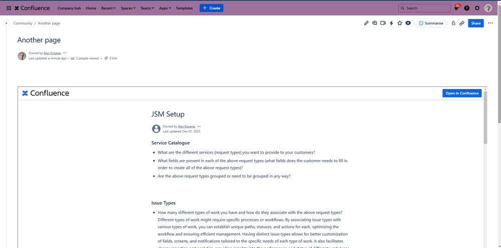

It is indeed impossible to achieve this with the include macro and with all the prerequisites you have. What you could do if to turn on the public link for the specific pages you want to share with companies B,C and D and add them as iframes inside other pages on spaces B, C and D. The result would be something like the following:
Of course, having a public link means that anyone with that link will have access to that page :/
