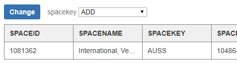

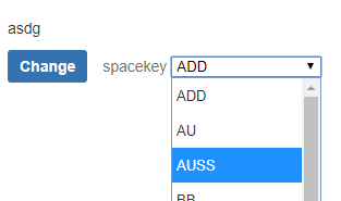

This is just a very simple standard HTML dropdown menu. Remember: If you want it to look more fancy you can always use the AUI styling elements. So this is what you should get:
Now we need to build the second query. Again, i will use a very simple example just to show that it works. This is where you need to include a dynamic parameter. (make sure the NAME of the dynamic parameter matches the pq_NAME in the template of the first query, or else this won't work)
SELECT * FROM confluence.spaces
WHERE SPACEKEY = :spacekey
Now simply insert the macro below your first macro and make sure that you enable dynamic parameters in the macro parameters.
You can now choose something from the dropdown menu and the second query will use it to get its results.
