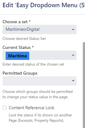

So I'm running my Page Properties Report with Table Transformer and Table Filter. It works great, but for some reason I'm not allowed to interact with the dropdowns in the the view shown below (showing some of the colums). I'm pretty sure that this worked before. Using Data Center version. When I hover over the dropdowns i see a message at the bottom left in the browser saying javascript:void(0).
When I open the projects themselves from this view, then I'm able to use the dropdowns in the Page Report without going into Edit mode, so the dropdowns themselves are configured in the right way allowing to interact with them in other views. see example below.
I'm also posting the Table Transformer Code at bottom here. Some of the columns that are not mentioned in the transformer code, like Unit and Type has the same error as the colums that are mentioned (like Status). I cant interact with any of the dropdowns.
Any help on this is greatly appreciated!

Hi Everyone,
I finally got around to do some tests and talk to our lead developer. Here are my findings:
- As Stiltsoft already told us, only the compatibility with EDM and the Table Transformer are an issue. The Table Filter works as intended.
- Looking at our commit history I haven't found anything that suggests, that there were recent changes that could have affected this behavior.
- Scouring our own Service Desk and Backlogs have shown that there already were customers reporting the incompatibility since Confluence 7. So the two macros were probably never compatible in the first place.
- One interesting this was, that my predecessors had opened a ticket with Stiltsoft support to investigate the issue, but sadly the ticket went stale after a while. @Stiltsoft support this would be the ticket.
That's everything for my findings. Now for what would be possible to do:
- If we made the two macros compatible, the fix would be released with the newest version of EDM (v7.0.1 or higher).
- We've already established that v7.0.0 is no longer backward compatible with Confluence 8, so you'd have to either update your server or request a backport in addition.
What we don't know at the moment is what causes the incompatibility. It could be on our side or on Stiltsofts side. Only further investigation from both parties will show us, what has to be done.
I hope i could provide some insights on the matter. Let me know what you want to do.
