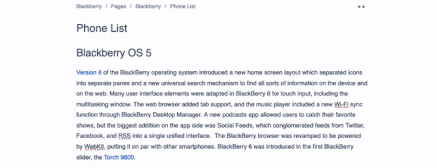

I tried to replicate this behavior in both the New and Legacy Editor. While using the New Editor (Fabric), I was unable to replicate this behavior. Here is what happened:

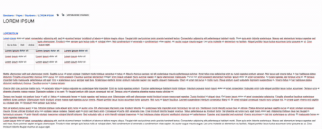

However, when I tried the same while using the Legacy Editor (tinyMCE), this behavior was present. Here is what happened:
As a workaround I was able to use the Backspace key to remove the line break and then add a white space after the link using the space bar.
