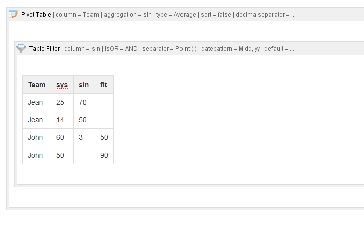

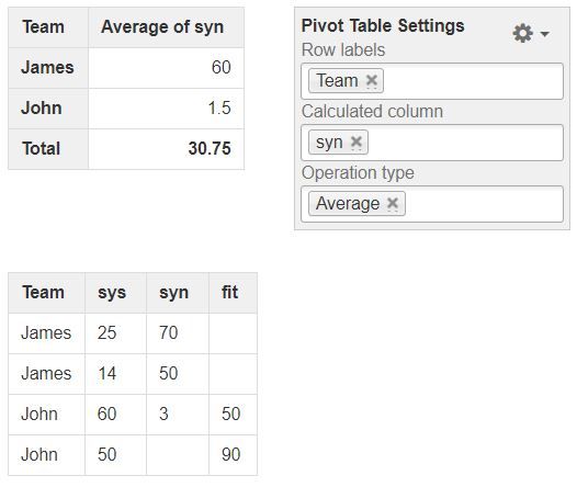

Here is the tables I am using. I would like the average for John to show 3 instead of 1.5, because the bottom cell for John is blank, not 0. But I think that confluence considers blank = 0. Is there any way to change that?

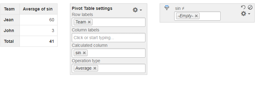

Did you try the following?
Mackenzie Clark September 15, 2017
How did you get the does not equal filter? Thanks for your help!
Andrey Khaneev _StiltSoft_
September 15, 2017
Just click the '=' sign next to 'sin' label to make it not equal and save changes in filter (option under cog wheel).
