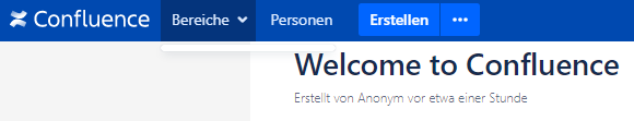

1 - I am not able to see or create any spaces:
The drop down menu is just blank.

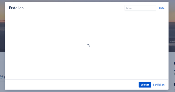

2 - When i try to create a page from a blueprint it just loads forever:
I already tried to reindex the content of the installation. Do i overlook something here?
EDIT: Solved the problem with the latest jdbc driver. Now everything works fine.
