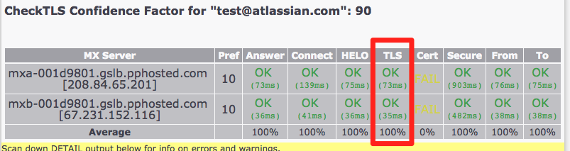

Bummer! If your SMTP server is accessible from the internet (i.e. you can send email outside your office without having to connect to VPN), you can try using the tool at https://www.checktls.com/perl/live/TestReceiver.pl - you can just enter some dummy email address on your domain like "test":
image.pngLook for the TLS column (highlighted above). If it's not OK, you'll need to work with your mail server administrator to get it enabled. This varies depending on what mail server you're using and is outside something we're able to help you with here.
If it does say OK, check with your network team to see if there are any firewall rules in the way between your JIRA server and your mail server over that port. It's also worth checking to make sure the mail server has a signed certificate from some place like Comodo, GeoTrust, or DigiCert. Self-signed certificates might cause a problem. If you're using Java 7, ther are also a few certificate providers like GoDaddy that require some extra configuration to be accepted by Java.
